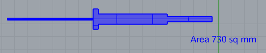

Actually, the vang black plastic body shown in my previous post has a surface area of about 730 sq mm. When you add the rotating gooseneck, vang–boom fitting and the main boom fitting, the total exposed area comes to roughly 3000 sq mm.
Vang black plastic.png (2.96 KiB) Viewed 26182 times

  • What are the dimensions at which a vang would break F.2.3?
  • What allowance should be made for different manufacturing techniques causing larger vangs – noting that F.2.5 allows that “Construction techniques for forming rigs are unrestricted”. Or are you ruling out the use of, say, 3D printed vangs?
  • Given that F.2.4(d) permits a gooseneck/vang fitting that is between 1200 and 2000 sq mm, is the maximum vang size that you are advocating in addition to this area?
The use of a vertical and horizontal dimension has been discussed in earlier posts noting that some skinny wire vangs reach a long way down the boom which would make a maximum horizontal dimension problematic – specifically, it would make non-compliant things which have long since been believed to be compliant.

1. Instead of measuring areas, it might be easier to just apply the method of rule F2.4(d) and limit the maximum cross section dimension at right angles to the axis of rotation.
2. The key question to me though is “do the majority of owners think the Viss vang is OK or not”
3. If you think the Viss vang is creating too much area then pick a number like 10 mm maximum which would disqualify the Viss vang.
4. If you think the Viss vang is fine, then pick a number like 65 mm which I think is the about the max horizontal dimension of the carbon plate on the Viss vang, not including the gap at the outboard end making up the adjuster.
5. I think a poll of the owners could determine whether the Viss vang should be allowed by the greatest number of votes. We should try to have the best rule for the class.

I hope SRC does not mind me borrowing this photo from their site?
I think this picture gives a good view of the concern to sailors, which is the area exposed when sailing downwind. Is it ok? Or is it too much?

In this photo I add a red line where a normal wire hook vang with a thin barrel might fit. Perhaps the “hockey stick” shape is not needed for the Viss to control leech tension? Vang angles beyond 45 degrees only minorly reduce vang tension.
