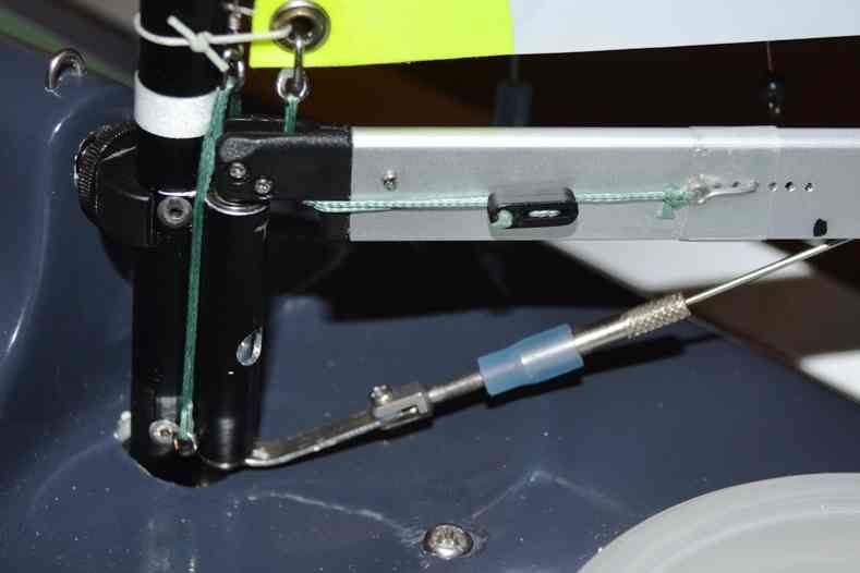

This picture was posted on another forum with the question "Is this compliant under this new rule"?
The plate connects the vang to the pivot screw - but it is exposed, it rotates, and it is longer than 20mm.
Or is the plate part of the vang?
Vang plate question.jpg (18.19 KiB) Viewed 155203 times
Contrast with second picture where the lower vang screw section attaches directly to the pivot screw.

Hi Roy,
The IOM class rules contains a 'grandfather' clause.
A.13.1 (d) A change of class rules that causes equipment in use to cease to be permitted,
except where the equipment may comply with the class rules in force at the time of
its initial certification measurement.
The problem here is that the interpretation said that those plates were not (and never were) compliant - and so are not covered by R 13.1.d.
