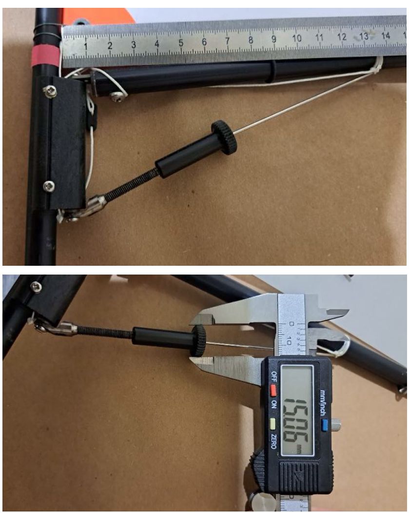

Dear

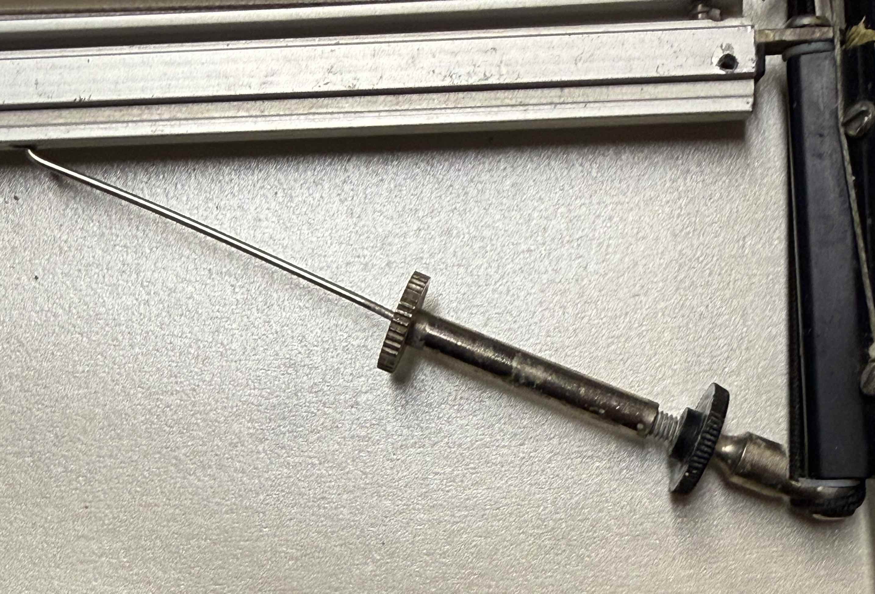

The surface area of the Viss Vang is 1739 sq mm, and can be seen at the following link: viewtopic.php?f=7&t=2111
This is a comparison with a vang that has been on the market for a long time, so I assume that it does not violate Rule F.2.3, and that our solution is therefore compliant with the rules as well.
The key question, in my view, is who determines whether Rule F.2.3 is being violated, and how the limit of Rule F.2.3 is actually defined.
To resolve this issue clearly and ensure that all existing vang designs remain legal, I would suggest the following approach:
Propose an emergency rule ( clarification/change ) that would go on the next AGM:
The vang must be able to pass through a 20 mm ring gauge with a maximum length of vang 200 mm
This would define a clear and measurable limit.

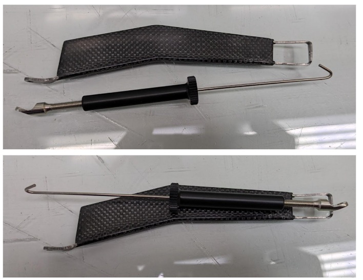

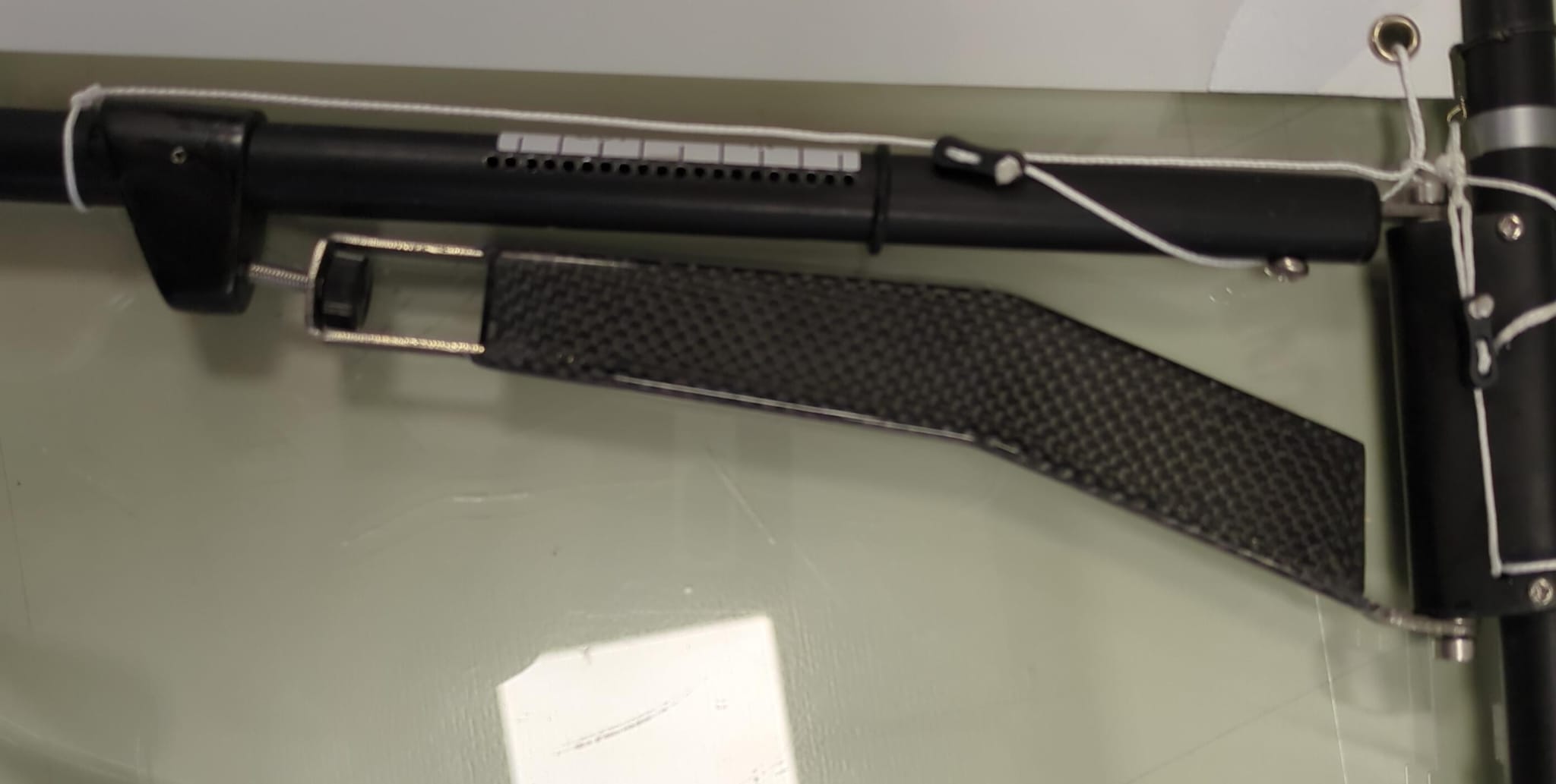

To Gabriel's point, and recognising the danger in ascribing motivation, the "bent vang" shown in Zvonko's response has the effect of allowing a boom attachment point for the vang that is further aft (further from the mast) than a straight line vang would be capable of having with a narrow cockpit (due to narrow hull) and low rigs. So the evolution can be understood as responding to the design direction that Gabriel mentions as opposed to a desire for more sail area.
Both Bruce and Zvonko are, in their own ways, arguing for a more comprehensive restriction than simply one dimension (e.g. the 20mm ring gauge). This implies a minimum of two dimensions that, in some way, control the ultimate surface area of the vang. At its most complete, Bruce's suggestion that the rules prescribe the "old faithful" vang would mean shifting to perhaps 3 dimensions - end point size (say 5mm), maximum mid point size (say, 12mm), and then length (say, 150mm). As I have noted in the discussion paper, this perhaps rules out 3D printed fittings and, given their increasing prevalence, probably penalizes the home builder more than is desirable.
Zvonko's suggestion of a 20mm x 200mm vang (ring gauge size and total length) would certainly be easy to understand and stop surface area growth. I would suggest that a 200mm length is around 50mm too much - but negotiation on size can come after agreement on the principle.

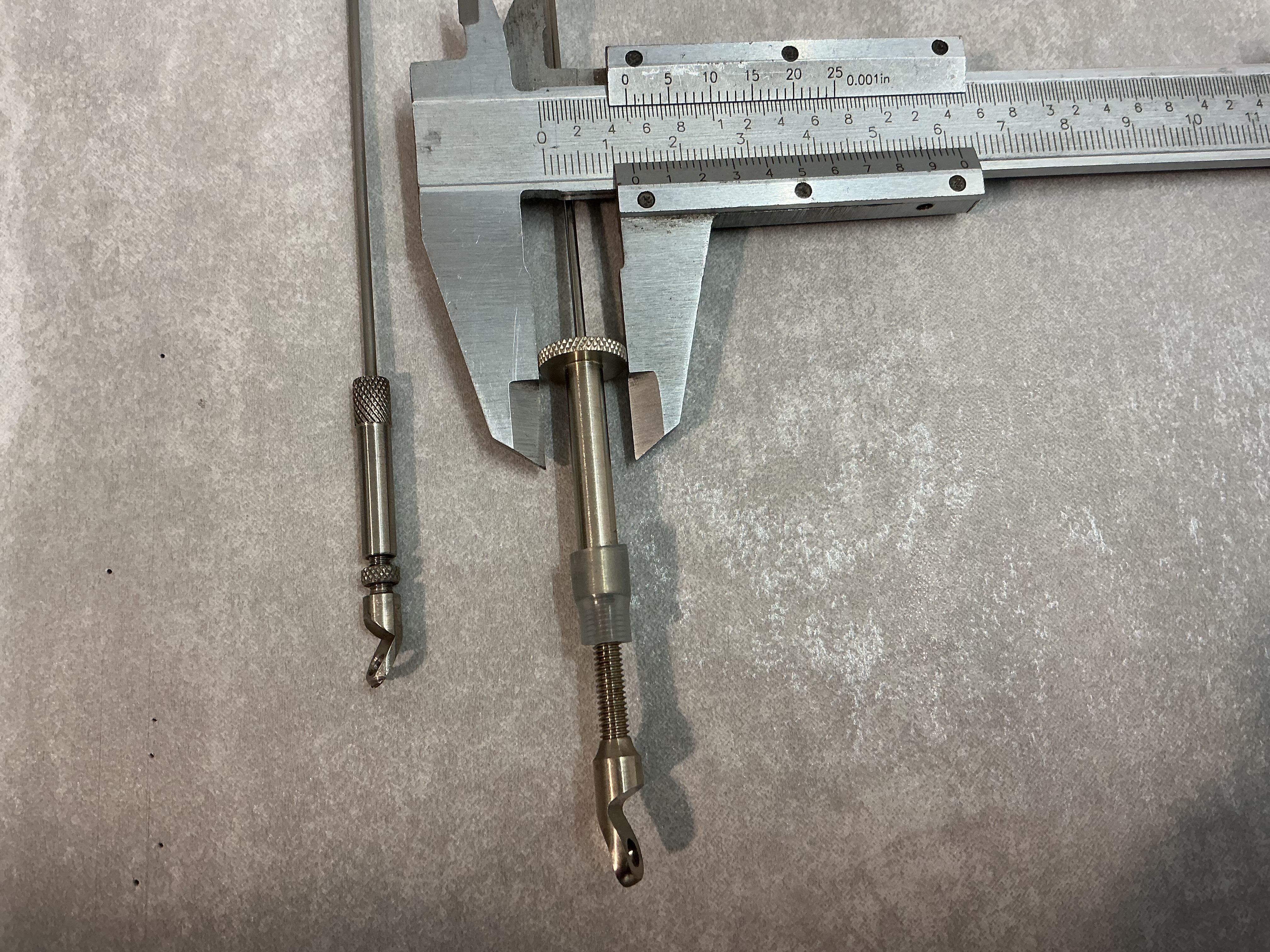

Above mentioned proposed dimensions will put out of the class vangs which many of us are using for years, if not for decades.
Maybe I was not precise with measuring the diameter of the fitting sold by one reputable supplier for years but it is close or even slightly bigger than 15 mm. Recommendation of the same supplier is to have hole on the main boom for kicking strap 130mm from the fore end of the boom, which is obviously more than 125 mm from the aft of the mast (as proposed above). I am quite sure that I am not the only one using such type of vang with this dimensions.
Do we really want to put to prohibit this type of vangs?

In keeping consistent with previous interpretations within the kicker body, Kicker/Vang region, I agree that the maximum length should be no greater than 100mm. The change I would add is that a kicker/vang is commonly set aft of and a with connection to a gooseneck body. Maximum permitted for this fitting is 20mm aft of the mast. There may be overlap within connection. So my suggested change allows a tollerance to be set no more than 125mm from the aft face of the mast.
It is imperitive that any rule voted on has a length restriction matched with a ring gauge limit.
Cheers
Brad Gibson (Designer/Manufacturer)
GBR 42
Robert Grubiša
CRO 68
Hi Robert,
As I have not used a kicker/vang from said providor for 20+ years, I am unaware that they were actually that large!
The only large oversized wheel example from another reputable supplier here measures 12.5mm at max wheel diameter as pictured. For reference I include a fitting used since 2007 on both my Widget and subsequent designs more suited to rigs being low in the boat without unnecessary weight.
From here my 15mm ring gauge offered would seem generous without removing anyone with existing fittings designed for their purpose and nothing more.
As to allowable positioning on the boom, like above I trust a sensible figure will be discussed and reached that better defines all limitations in staying true to a closed rule set.

For many years the kicking strap has been a simple SS wire hooked into a hole in the underside of the boom with a threaded adjuster.
For some reason builders and designers felt the need to use a CF plate instead.
If the claim is the CF plate is not intended to enhance sail area, then why use it?
There must be some benefit to the CF plate vang that makes the wire vang obsolete now.
Also, as per the class rules, the vang can only work in tension and not compression.

The question of a vang being in compression did arise at the 2024 Worlds. During pre-event measurement, the vang was checked to ensure that there was "play" in the adjuster such that the boom could move in the downward direction indicating no compression. It was the adjustment mechanism that determined this and not the overall design of the vang - C/F plate or otherwise.
As I speculated elsewhere in this thread, the large C/F vang shaped like an ice-hockey stick could be a response to the need to clear cockpits in narrow hulls. The alternative is an attachment point for the vang that is very close to the mast which, presumably, has an impact on the force that the vang is able to exert under load.

Regarding production, in my case, it is easier to manufacture a VISS vang than a standard wire with a threaded adjuster.
For the VISS vang, you need 2D laser cutting ( or it all can even be cut by hand ), plus a small amount of epoxy and carbon fiber.
For the wire-and-threaded-adjuster solution, you need 3D machining, which, for example, I do not have good local access to.

When the Mainsail Boom Vang fitting (F.4.3(a)(3)) overlaps with the boom—as shown in the attached picture—should that overlapping area also be included in the projected surface area calculation?
In my case, that overlapping portion is approximately 200 sq mm.
From a functional standpoint, this overlapping area does not contribute to an increased effective surface, so it is unclear whether it should be considered relevant when assessing excessive size.
Just to clarify, as far as I can see, the gooseneck that is fixed to the mast is not included in the list, and therefore is not counted in the projected surface area calculation.
VISS Vang Area Calculation
The total projected area of the Mainsail Boom Vang fitting itself is 375 sq mm, plus additional stainless steel parts that were not included in the original VISS vang calculation (as shown in the link www.iomclass.org/phpBB3/viewtopic.php?f=7&t=2111 ).
When all of these elements are added together, the VISS vang would end up over the proposed 2,000 sq mm limit.

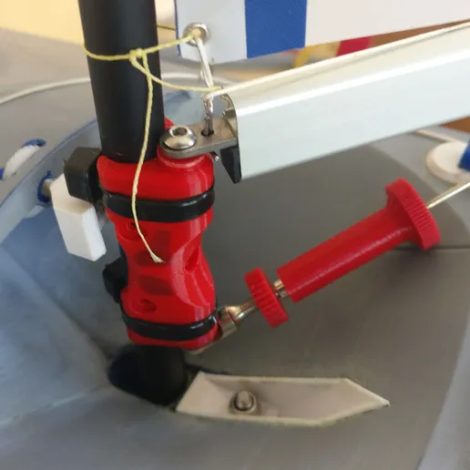

I have attached an image of a randomly selected (via Google images) 3D printed gooseneck (by historical3dmodels). As Brad notes, its size is larger than a metal/CF equivalent, but it is also clearly “… no larger than is reasonably required”. As it does not rotate (it is permanently attached to the mast), its area is not relevant to the 2000 sq mm limit. The 3D printed vang component, however, does rotate with the boom/sail and so a measurer should satisfy themselves that its surface area is less than 2000 sq mm (which it clearly is).
To slightly complicate matters, some feedback from Olivier Cohen has made me realize that I need to change the words “… sum of the projected surface areas …” to be “…sum of the surface areas of the projected perimeters …”. By this I mean that any interior features (such as holes in particular) should be ignored for the purposes of the surface area calculation.
Given that, what my “… projection of surface areas shall be to the centre plan of hull with the mainsail boom centred …” is meant to mean is this: if you remove the rig (mast, sails, etc) intact from the boat, lay it on a flat surface, and then trace around the boom vang fitting, vang, and any rotating parts of the gooseneck and mast vang fitting with a pencil, the resultant shapes are the ones that have their area measured.
Importantly, I would note that there should be no requirement for a measurer to record the areas calculated using the above method. The measurer should be required only to satisfy themselves that the sum of the surface areas is less than 2000 sq mm. Given that the sum of the areas of the “old faithful” vang/gooseneck/boom fittings shown in my last post are so far under 2000 sq mm (indeed, one could be 200% out in calculation and it would still be compliant), a quick glance at such a fitting by a measurer should be enough for that purpose. When designers currently seek clarification on the compliance of new rotating gooseneck fittings, there are asked to provide drawings/pictures that allow a determination to be made as to their compliance under the current F.2.4(d) (i.e. the 20mm rules). I would expect the same for fittings that might need measurement under the 2000 sq mm rule to ensure their compliance.
Finally, to Zvonko’s suggestion that the allowed area be greater than 2000 sq mm. I would observe the following:
  • 2000 sq mm, as I have noted, flows naturally from the limits allowed by the current F.2.4(d) and so does not represent any radical change in that regard and, of course, it permits the use of existing fittings.
  • Perhaps more controversially, the reaction to the size of the Viss vang suggests that it represents the absolute limit of what is to be accepted. When I imagine a vang twice the size, and the resultant concerns, I feel the need for a cautious approach to the maximum allowed area.
