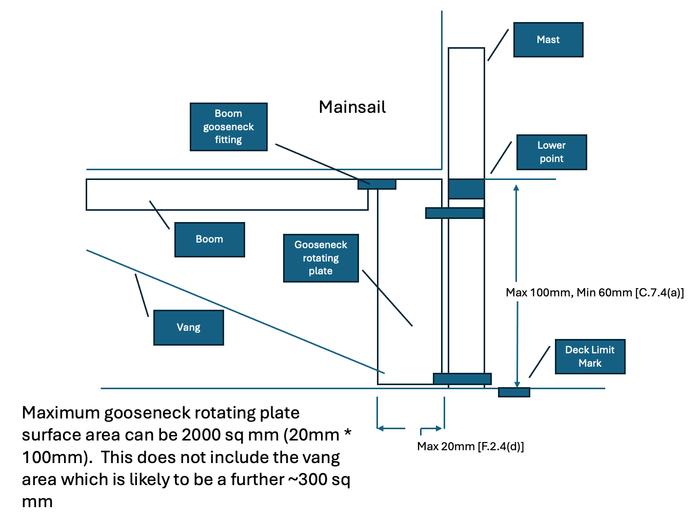

I have no doubt that the larger “plate” style vangs are intended to add some advantage. I do not personally know what that advantage is intended to be but, provided they are compliant with the rules, there should be no issue as the IOM Class Rules do not define a “one design class”. Suggesting that an innovative design is somehow underhanded or a-priori non-compliant stretches the meaning of “closed class rules” beyond its intention. However, and this is how we find ourselves in this conversation, the rules do not specify any dimensional limits to the size of a vang, so how are we to determine whether these larger vangs are compliant with the rules?
Class rule F.2.3 (the only applicable rule when a vang as a single, un-combined fitting is being discussed) is frequently invoked as establishing a size limit for the vang. Class rule F.2.3, however, makes no mention of size/dimension:
Unfortunately, Interpretation 2015-IOM-1 makes no specific statement as to how big a fitting needs to be for this additional function to manifest itself. It is unsatisfactory to say that any surface area adds additional propulsive force - in that case, all fittings are non-compliant under Rule F.2.3. Rule F.2.4(d), which was implemented as a result of Interpretation 2015-IOM-1, provides the only dimensional “clue” as to how big a fitting (such as vang) can be before it adds material propulsion (and so becomes a sail as well as its normal function) thus triggering F.2.3.
So, it is a reasonable interpretation of the rules to suggest that if a gooseneck/vang fitting with a surface area less than 2300 sq mm is allowable, a vang of similar size is also allowable and does not breach F.2.3.
My proposals, therefore, are not being written to “… include the Viss vang”. They are, rather, being constructed to ensure that we:
I would add that this is not an unusual approach to some of the class rules.
We do not, for example, seriously ask people to measure “… the difference between the largest and smallest value along the spar of any wall thickness dimension …” to determine that the variation is less than 0.1mm (F.3.4, Spar). Measurers understand that rule to mean that variable wall thicknesses along the spar, intended to stiffen the section at strategic locations, perhaps separated by mast joiners, are not permitted. However, if the mast is a continuous piece of aluminium section, it is taken as read that the wall thickness is constant without the need to get out the bore micrometer to check.
Apologies for the long post but it as well to ensure common understanding of where we current sit in the conversation.
- F.2.3 LIMITATIONS
The function of items shall be limited to what is normally provided by items of their type.
- F.2.4 CONSTRUCTION
(d) Where the mast vang fitting and/or gooseneck:
(1) are exposed,
(2) are not of circular cross section, and
(3) rotate,
They shall not exceed 20mm in any cross section perpendicular to the axis of rotation.
- have a better-defined and more comprehensive size limit (to avoid future problems)
- prevent combinations of fittings exceeding a defined limit.
- keep any existing fittings built to the current rules compliant

It does appear to be good news that the concept of a defined combined surface area for all fittings that rotate with the boom has a level of consensus. We are left, as I alluded previously, with the task of understanding what that number might be. At present, we have a range between <2000sqmm up to Odd's 3300sqmm.
Both Brad and Odd have described the pragmatic path - albeit that Odd has specified the number - in which a line is ruled under this whole saga and we simply move forward All vangs that were able to pass the 20mm ring gauge test would likely be compliant under the new surface area rule. While I accept this will not make everyone happy, the reality is that it is a difficult task, with considerable rule divining gymnastics required, to find a basis upon which these vangs have ever been non-compliant. Yet we all agree that there must be some limit.
While I do not agree that the results of the World Council votes are definitive in this discussion - the 20mm ring gauge test did not define any upper limit of area - I do agree that they should have some bearing in the sense that they perhaps point to what may be acceptable in some future vote. Which, if there is to be an emergency rule change, there must be at some point.
Given the above, we are narrowing in on a number north of 2500 sq mm and south of 3300 sq mm as being able to accomodate those that have come before yet drawing a clear rule for those that come in the future.
