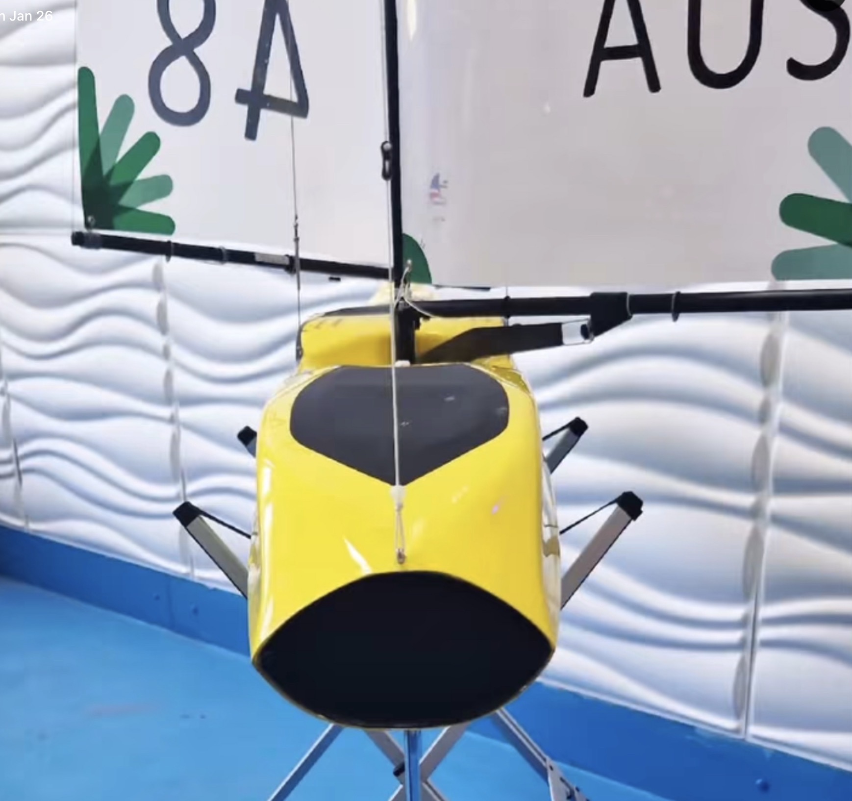

Post by Bob Lewis » 30 Jan 2026, 07:53
I hope SRC does not mind me borrowing this photo from their site?
I think this picture gives a good view of the concern to sailors, which is the area exposed when sailing downwind. Is it ok? Or is it too much?

Post by Bob Lewis » 30 Jan 2026, 07:56
In this photo I add a red line where a normal wire hook vang with a thin barrel might fit. Perhaps the “hockey stick” shape is not needed for the Viss to control leech tension? Vang angles beyond 45 degrees only minorly reduce vang tension.
