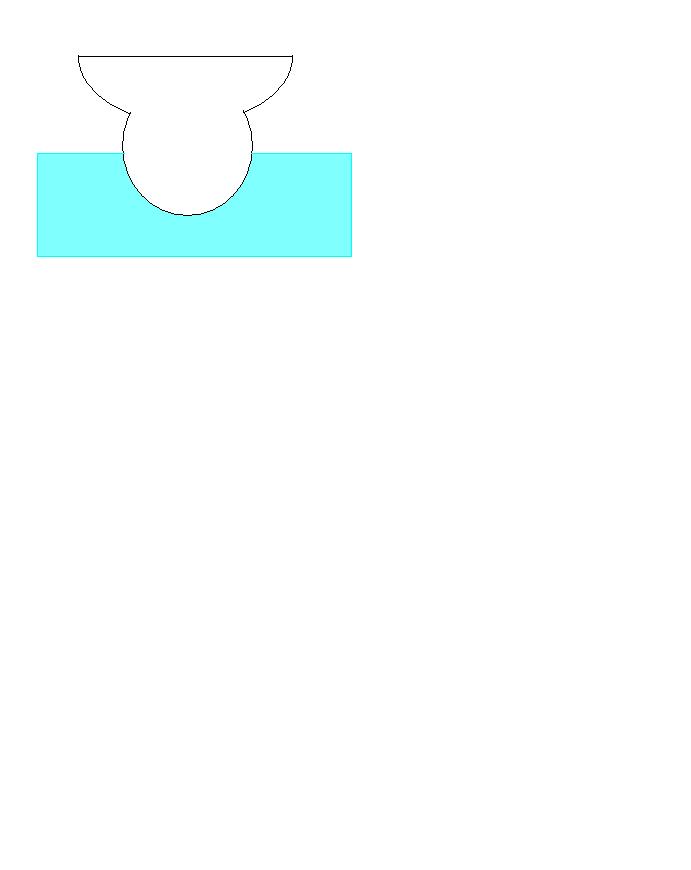

Im trying to penetrate the wording of D.2.2 b at the moment and failing (it could definitly use a little clarification in my opinion) so I thought I would just post my question here:
Assuming that all the dimensions adhere to the IOM rules and just considering the shape, does the hull shadow below contravene D.2.2 b (or any other rule) and if so, why?
Cheers,
Andy

Re: D.2.2.b confusion
Hi Andy
As far as I can see, your cross-section doesn't fall foul of the D.2.2 rule!
Lester Gilbert
http://www.onemetre.net/
Thank Lester!
That gives me the confidence to start a build
Cheers,
Andy
